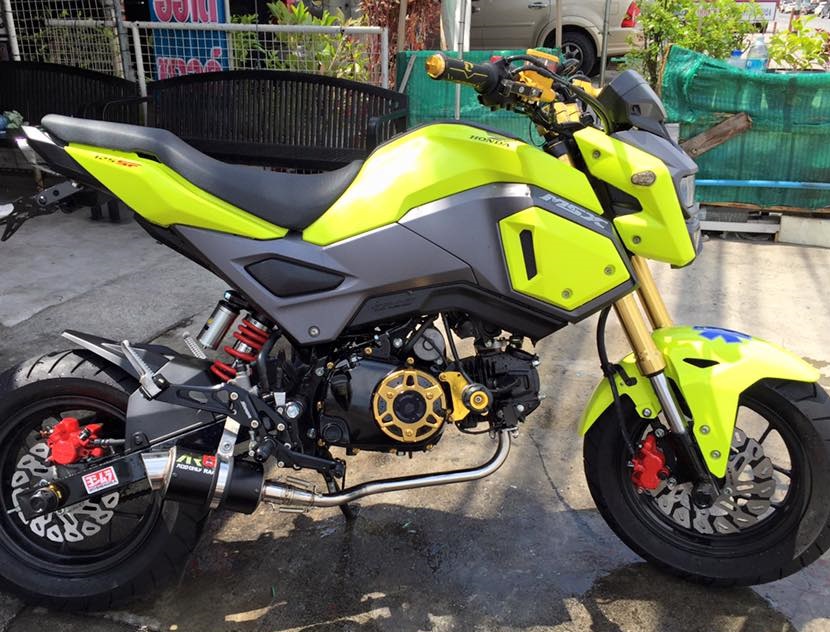

BeitragVerfasst: Sa 9. Jul 2016, 10:43
133251kx438zi43dcnj4qc.jpg [ 189.49 KiB | Array ]
